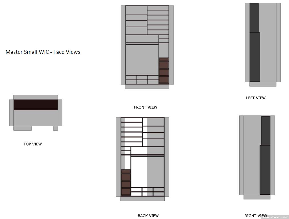

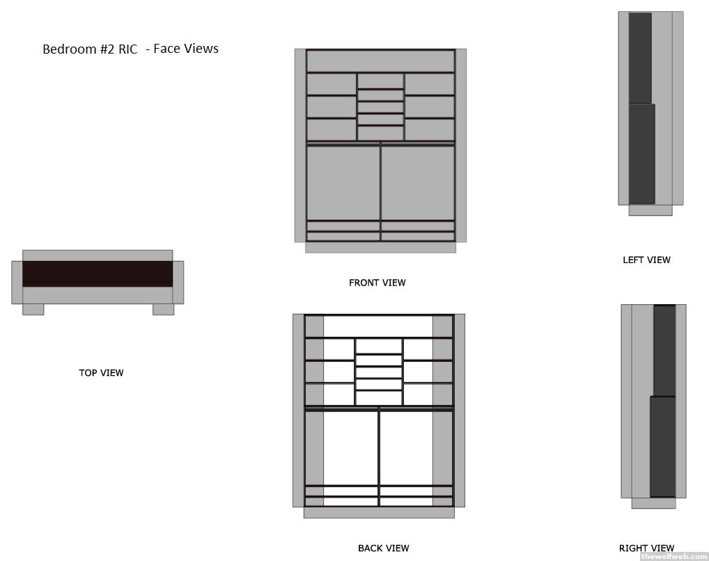

Thanks for the input. I've taken some of those ideas and some measurements to update my designs.
I've done preliminary designs for all 4 bedroom closets (master large WIC, master small WIC, bedroom #2 RIC, and bedroom #3 RIC).
Overall, I like my two RIC designs. I don't care much for my large master WIC design, but I'm not sure what do do. I also like my small master WIC design, but I don't know if that's what I should going for or not. I'll be using mostly adjustable shelving with basic shelf standards.
I'd appreciate any input on these. I looked at ikea's website and didn't see much that I cared for, and I'm looking forward to actually building these anyways. Also, instead of bombing this thread with tons of pictures, I'll just show 1-3 and post a link to my gallery for the rest.
Thanks for your input.

My only concern is that you do not have any full length hanging space other than the large master WIC.
Can you give me the dimensions of the two master WICs?
6/4/2012 3:51:46 PM
true, didn't think about that. It should be easy enough to provide full height space in one half of each of the other 2 closets (just remove the lower shelving).
I've estimated the closet dimensions at:
Large Master: 8'x4.5'
Small Master: 5'x3'
Bed #2: 7'x2'
Bed #3: 5'x2'

mdozer73
8005 Posts
wdprice3, in the small master, i would shorten the unit on the back wall and put in another high bar along the left wall to use up the empty space in the corner (L-shaped unit).
I would also stay away from drawers because they are expensive to build and they are less efficient storage (unless you are looking to get away from a dresser/chest-of-drawers in your bedroom).
FYI, I use about 10' of closet rod and my wife uses about 19'. Only 3' of our closet is full length hanging items (but when you need it, you need it).
Another idea is to build 12"x12" cubes instead of long shelves. That way you can buy bins that fit in the cubes and give you drawers for less $.
6/5/2012 4:53:14 PM
^thanks. I'll see how a high rod on the left looks. I'll also change the 2 other bedroom closets to have a high rod on one side of each closet. The builder is providing those wire shelves, which give you lots of rod space; however, my configuration has only about 3' less rod length (all combined) than what the wire shelves are providing.
I was hoping to use drawers/shelves in the closets to take the place of a dresser in the bedroom. However, I didn't know that they were expensive to build. I'll look into decreasing the number of drawers and just doing shelves. Also, most of the higher shelves will be adjustable.
I want to keep some drawers in the large master for clothes and the installation of a small safe (so it's not visible).

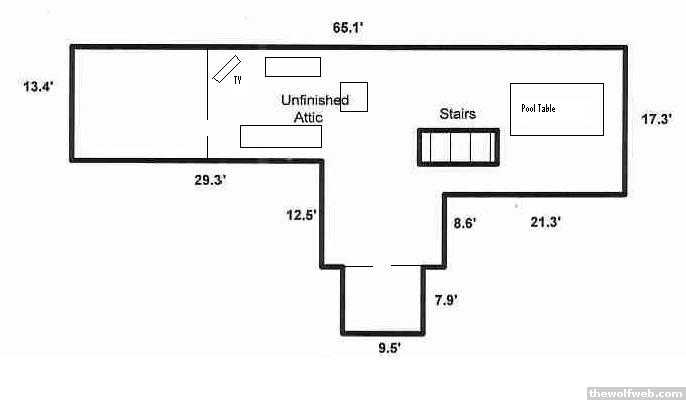

I finished my entire upstairs, about 1100 sq. feet. I promised I would post before and after pics like 2 years ago. Finally went through and took the pics. Started Jan 09, finished November 2010 (For the most part). These after pics were taken a couple of weeks ago though.
Sorry after pics are blurry. Took them with phone.
Before and After
Pool Table Room
Foosball and Bathroom
Sitting area and Workout room. That wall was added to make the workout room.
Workout room looking out
Midway and After
More pics
7/2/2012 2:53:48 PM

That's really impressive. Did you leave any room for attic storage? Or did you not need it?
7/2/2012 6:56:30 PM
scotieb24
Commish
11122 Posts
There is room behind almost all of the walls that are accessed using those short doors you see in the pics. I also need to state that I had a lot of help with this from family and friends so it was more of a do it with family and friends project. Gotta work on that name, doesn't sound right.
7/2/2012 9:43:33 PM
Beethoven
4080 Posts
Did you already have plumbing upstairs? If not, what would you estimate the cost of adding the bathroom alone was?
7/2/2012 9:49:02 PM
