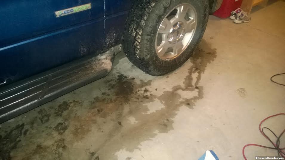

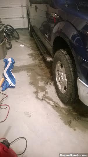

any advice here? snow/slush on the undercarriage and in the wheel wells, melting in the garage, creating a mess. and I've learned that my garage is ever-so-slightly crowned at the middle, so some of the water creeps towards the walls.
what would you guys do for a long term fix? I'm currently just using towels and a Shop Vac. I'm not going to start parking on the driveway -- that defeats the purpose of having a garage

I've seen parking mats that are designed to catch melted snow and whatnot, but I don't have any pesonal experience so I did a quick Google search and found an interesting article that may be helpful:
http://allgaragefloors.com/best-garage-floor-mat-snow/

Someone on the garagejournal forums had a whole thread about the melted snow/ice situation in his garage, and did something with mats as well.
i'm not gonna go pull it up for you, but i'm sure you could find it -- the search on their forums is pretty good.

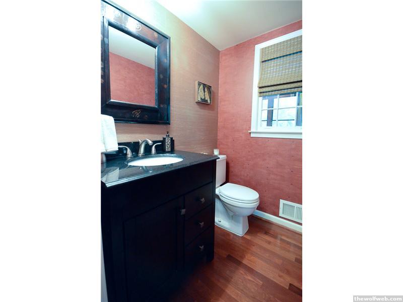

wallpaper gone - before picture is from when the house was listed
