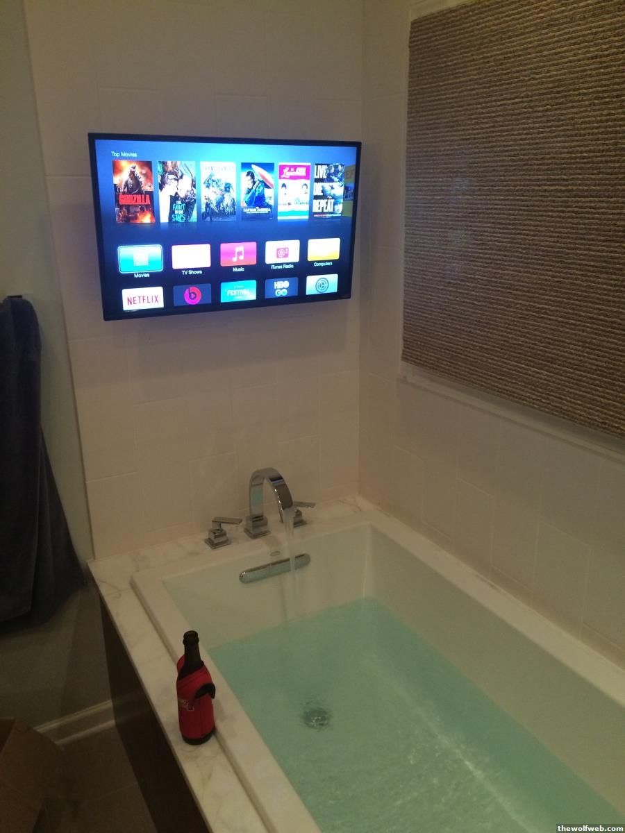

fixed the stopper in the tub today and decided a soak was in order - caught up on ray donovan

I've wanted to do that in our bathroom, but have been concerned about the moisture and how it might ruin the television.

the last owners put in the mount and did the bathroom and they had a tv in there for the 6 months they lived with it without issue - no idea on long term though - i just mounted the tv this past weekend
the concern though is partially why it's a $200 vizio - realistically it's used mostly for streaming colbert or music while getting ready in the morning because we very rarely take baths - the previous owners also put in a great fan right over the shower and the mirror never steams up like in past bathrooms if the door was closed

something like this might help with any potential humidity threats: http://amzn.com/B00H3QQD64

"but have been concerned about the moisture and how it might ruin the television"
my neighbor has had a tv on his deck for the past 6 years and it still works great (and he has it on nearly every night). My parents have one on their screened in porch that still looks great after 4 years (use every sunday for football).
I wouldn't worry about the moisture.
