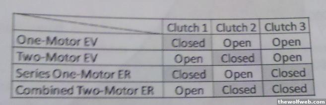

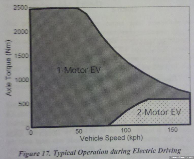

So I've been studying the Volt in an effort to understand its various modes of operation. There is some confusion and misinformation floating around the internet about it.
The Voltec 4ET50 transaxle has two planetary gearsets, one for splitting power and one that functions as the final drive. "Motor B" is the main electric driving motor. It is always attached to the planetary carrier. "Motor A" is the generator which also functions as an auxiliary driving motor. It can be connected to the ring gear through a wet clutch pack ("Clutch 2"), the kind you normally find in a traditional slushbox. The internal combustion engine can be connected to the generator through another wet clutch pack, "Clutch 3". "Clutch 1" is a holding clutch pack meant to stop the ring gear from moving.
The Voltec has four main modes. The first two are for electric operation only:
1) Single electric motor mode - during this mode, the Motor B directly drives the wheels. Clutch 1 engages, making the ring gear stationary. The planetary carrier rotates and directly drives the sun gear, which transfers power to the final drive unit. Functionally speaking this is like having the car in 1st gear during electric driving mode. It provides the most torque to the wheels but is less efficient at higher vehicle speeds.
2) Two motor mode - this is like having the vehicle in 2nd gear during electric operation. This was simpler and easier than having an actual 2nd gear in the transaxle. In this mode, Clutch 2 engages and power is supplied to the ring gear from Motor A and to the plantary carrier from Motor B. The Volt can continuously vary the speeds of the two motors to keep the vehicle at an efficient operating point in high speed operation.

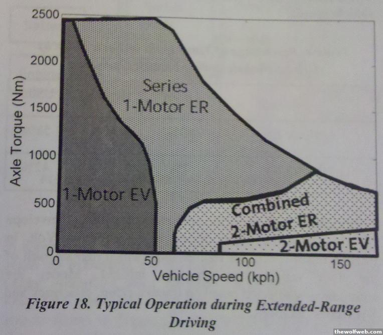

The Voltec has two more modes, which are used during extended-range operation.
3) Series One Motor extended range - this is what you normally would think of when you are talking about a series hybrid with a generator functionality. Clutch 3 engages, connecting the engine to generator. The generator supplies electrical energy to charge the battery. Clutch 1, the holding clutch pack, keeps the ring gear stationary. Motor B, connected to the planetary carrrier, drives the wheels just like in single-motor electric operation. There are two problems with having the engine only charge the battery during range-extending mode: just like in single motor electric operation above, you have inefficiencies at high speeds because the system is essentially still in 1st gear. The second problem is that there are a lot of energy losses as energy converts from gasoline to flywheel torque to electricity, then back into driving torque again.
4) Combined Two Motor extended range - this mode seems to be criticized and poorly understood. It is the extended-range version of the electric "two motor mode" above. Clutch 2 connects Motor B to the ring gear and the two electric motors' speeds can be varied to stay in an optimum range, just like the electric two-motor mode mentioned earlier. Clutch 3 connects the engine to Motor B. The engine never directly drives the wheels. The whole point of this mode is to reduce mechanical losses and use a better effective gear ratio for high speed operation.
