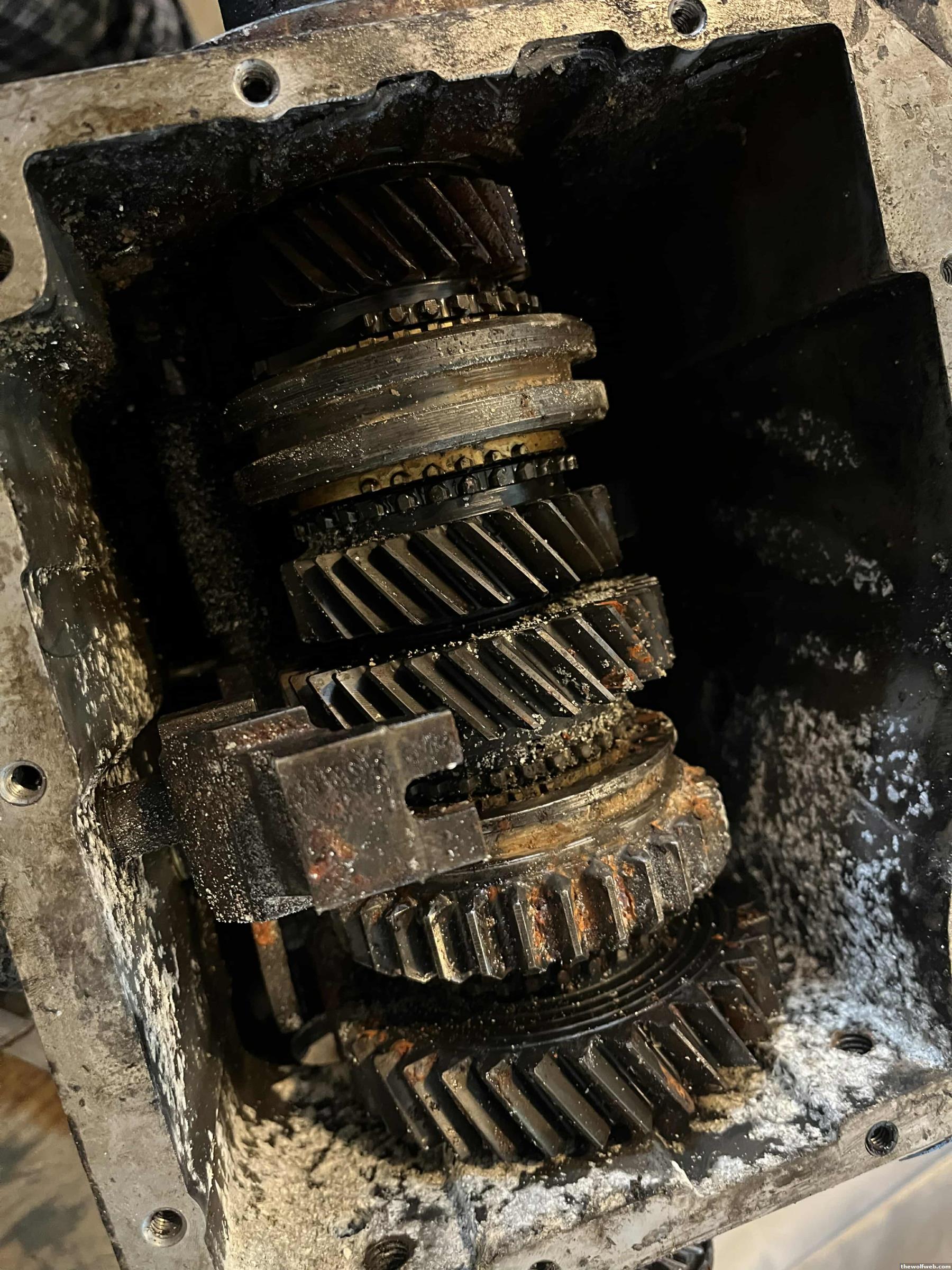

After months of procrastinating, I kick it in to high gear this Spring. After figuring out which clutch bits go on the car, I mount the flywheel, clutch, PP, etc. I have the car seller's used clutch kit, a brand new clutch kit I bought, a new clutch kit which came with the new engine, AND a 350Z clutch kit which also came with the new engine. Keep in mind that I'm taking the time to wire brush every bolt that I use from here on out.
I roll the car in to the car port, dust off all my gear, and get the engine in to the car. Cue all the associated difficulties and cussing.
Transmission time. No transmission jack means the trans is teeter tottering on the little 6" floor jack cup the entire time. Lots more cussing but it finally slides in. Whew, bolt it up and try the shifter! The shifter DOES NOT SHIFT. I can't even move it side to side. The slave cylinder pushes the PP back and forth as it should. Clutch in, I can turn the engine over by hand; clutch out, I can't. W T F I remove the transmission and recheck all the clutch components to make sure nothing is binding. I double check that I chose the correct parts; they're all good. Reinstall the trans; same thing. Fine, let's tear down the transmission:
FUCCCCCCCCCCCCCKKKK YOOOOOUUUUU. Is that MF'ing fungus?! The damn shift selectors were seized together, among other things.
But it's a T5 transmission found in a bunch of other cars. It should be easy to find, right? Nope, it's got odd size shafts, spline counts, etc. After dismissing the idea of buying another 40-year old transmission for $500+, I study up on how to rebuild it. The gears themselves are in good shape: no shearing or chipping. $300 in parts later, it's rebuilt. It's notchy as hell to shift, but my old boss says his Foxbody is the same way. OK moving on.
I remount the trans. Reminder: the car was halfway through a manual swap. I grab the driveshaft and insert it in to the trans. THE YOKE DOESN'T FUCKING GO IN. It's the wrong god-damned driveshaft. Even if it did go in to the T5 trans, the diff end was different from my diff flange. Fine then, it had a bunch of slop anyways. $400 for a brand new one.
