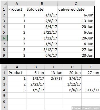

I have three columns and about 7k rows. I need to return the Sold Date values in the upper screenshot to the now transposed values of Delivered in the lower screenshot.

use a pivot table

Rabies. Max setting. Thanks.
