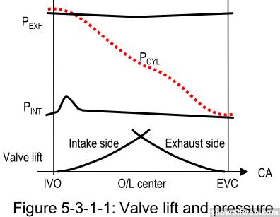

2) Intake air pushed back into the intake port as the intake valve opens during overlap. This one's a little harder to visualize so here's a diagram:
See that little "Pint" line? That's backflow into the intake port during overlap. If the intake valve opens before top dead center the piston is still rising. If sufficient exhaust gases remain in the combustion chamber and exhaust pressure is higher than intake pressure there will be backflow into the intake port as the piston rises. The backflow will create a pressure pulse in the intake port that can be timed to push air into another cylinder as its own intake valve is closing.
