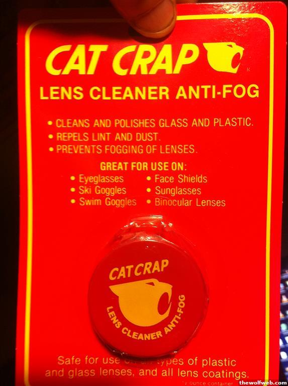

Tried the soap trick today. Not bad!
somewhat blurry, but clear enough to watch an arc gap. fogging, however, was a complete non issue.
Your bringing up cycle helmets made me think we likely face similar challenges (except for the part where you have loads of wind and stuff to vent through if you so choose.)
Did a little youtubing and found bikers going crazy over this stuff.
Saw a few demos and by most accounts it looks to be pretty damn legit.
Got a pack today
Dunno bout the name...
If it works I'm so totally shilling for that company though.

The Cat Crap worked like a boss!

I was gonna suggest the PAPR welding hoods. We use them for welding jobs where hex chrome is a concern, but they definitely help with fogging and keeping you cool in general.
We had Cat Crap at one plant where I worked, but I never tried it. Glad it worked for you.
