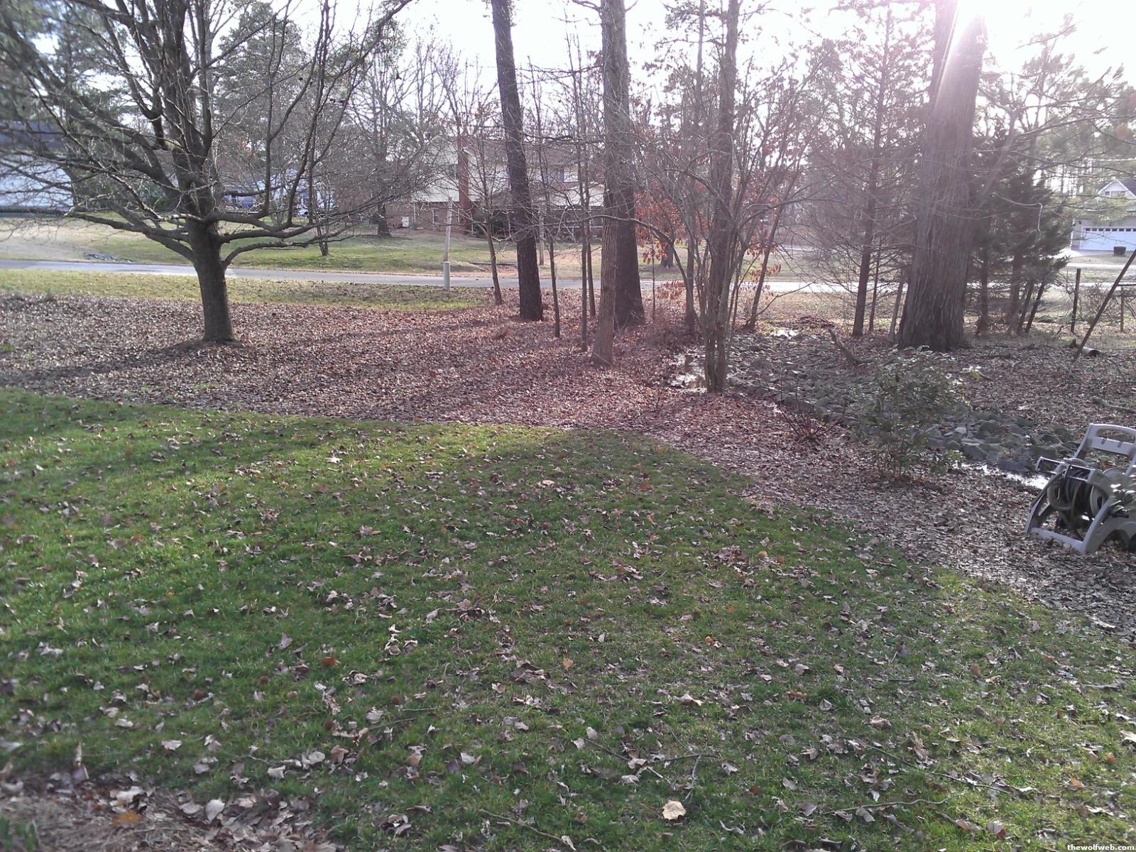

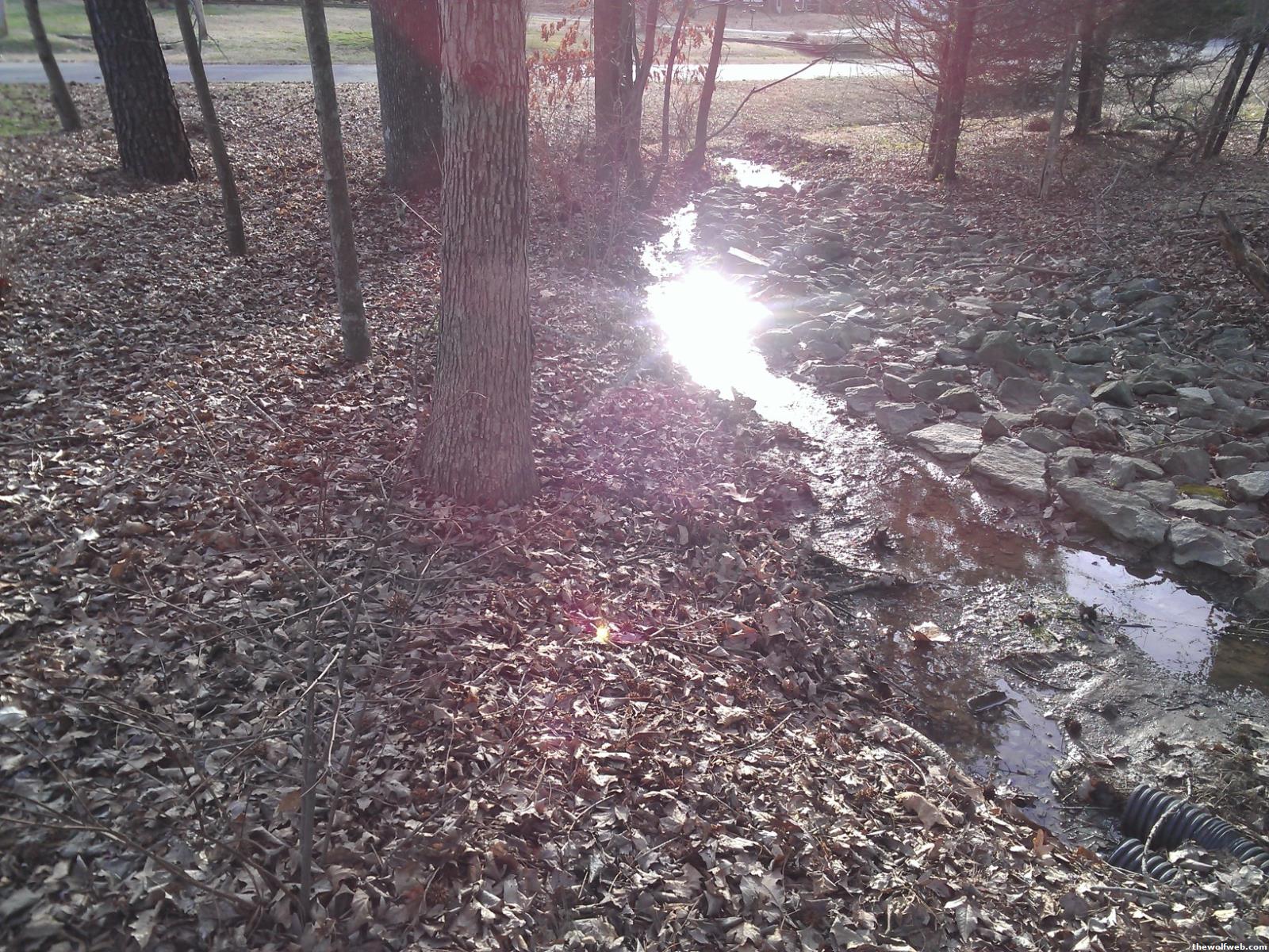

Here's some pics.
You can see, there is a ditch along the road and on the right.
The drain outlets are on the bottom right. The property line is about a foot to the right of the outlets. The rocks and water are on the neighbors property.

I know drainge, but not how residential laws apply here. What exactly is the complaint? I see the neighbor's "improvements" which didn't work, likely because whoever did it didn't know what they were doing. Is the ditch draining more than your 2 properties (e.g. does it come from properties behind you)? If so, AFAIK, there's nothing the neighbor can make you to do, as drainage ways are more like easements (even if not legally called an easement); however, if you (or previous owners) have done something to change the hydrology/hydraulics and it causes damage, then you could be held liable for the damage... I think.
I don't see the point in extending your pipes when there is a ditch right there. And it won't solve the apparent issue, unless your two drains are the primary source of water to the ditch. The issue is the ditch and erosion control. You need some stone at the end of your pipes and the ditch needs a defined channel. Throwing a bunch of rocks on the ground doesn't help much. The water has obviously done what water does and found the path of least resistance (formed an incised channel beside the rock).
If you two were going to fix this, then you would take up all of that rock, grade in a proper channel, large enough to handle common flows (10-year event), lay down some filter fabric/high quality landscape fabric, then some NCDOT A and B stone. Be sure to incorporate point sources (such as your 2 drains), e.g. , wrap fabric and stone around those.
