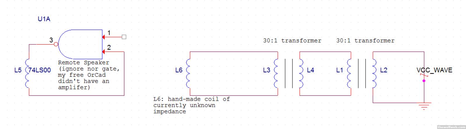

So I'm trying to figure out a way to make a speaker hum remotely (my sights are pretty low... Any sound will make me happy).
I have 2 30:1 transformers and a bunch of wire. I've tried just coiling the wire up around a cylinder, hooking the transformers up in series, and using a tone generator app on an iPad to run a signal through it from a home theater amp. I can get about .6V p-p at around 14khz, too much lower frequencies trigger the protection circuit (note: I don't care too much if I fry this amp).
With no load, I can get about 350 volts out of the series of transformers. I have an a assortment of speakers around me, and none hummed (the transformers were hissing however).
I think what I'm missing is coiling the wire the correct way. I've got some capacitors laying around, but I assume there's some way to get some humming just by finding the right frequency and coiling the wire the right way.
I'm thinking I need to go for higher current rather than higher voltage with the transformers (basically reverse the way I had them) and do some actual calculation in my windings to find an inductance that matches the impedance of the system better.
Any suggestions? I pretty much don't remember any of my AC circuit stuff, I'm trying to brush up.

36246 Posts
I want to create a mutual inductance between L5 and L6, with the only fixed parameters being the signals have to be in the audible frequency range, and that my 2 transformers are fixed to their list values:
I mainly need to know the best way to go about determining what L6 needs to be, and should I hook my signal generator up to the higher-wound side of the transformer (increases current on output) or lower-wound side (increases voltage level on output).

How about a block diagram...with basic inputs,outputs/what you want to archive.
8/27/2013 2:06:26 PM
36246 Posts
The previous diagram is as basic as it really gets. Just pretend the things are blocks, and you have a block diagram.
Just making this thread is giving me a better idea of what i need to do... have to do some impedance matching between the transformers and source/sinks.

36246 Posts
Okay, you remember back in the days when you put your cell phone near your computer speakers and they made sounds?
I want that to happen, but on purpose, with me controlling it.
I operating under the assumption that inducing baseband audio signals would work. 1) This could be a bad assumption 2) i might not have the right parts to do it.

AntecK7
7756 Posts
I don't know, and i've been outa school for a while... But I think the cellphone was was influencing the amp, not the speaker itself.
I don't see you generating a field big enough to actually move the speaker

36246 Posts
The speaker will be hooked up to an amplifier.
This ultimately, if works, will turn into a prank...
