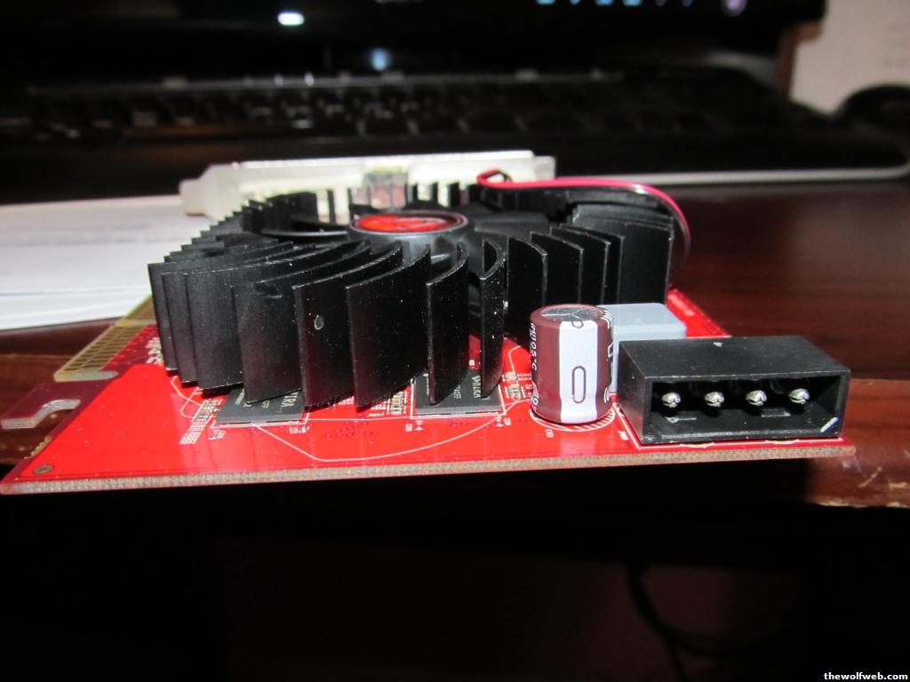

disco_stu
7436 Posts
Can't find the card on newegg but from the picture it does look like it requires an additional power cable from your PSU.
It's not very likely that your dimension has the necessary power supply to work with that card. I'm not speaking with certainty since I haven't taken the time to find the reference for that card but if that black box in the upper left part is the connector that I think it is then you probably don't have the power supply for it.
Open your case and look for cables coming from your power supply. Are there any extra ones that aren't currently connected to anything with 6 pins?
Found this:
http://www.bjorn3d.com/2009/09/visiontek-hd-3650-agp/
Looks like VisionTek's first revision used a floppy power connector which actually would probably work for you but the picture definitely looks like a standard 6-pin to me.
Have him send you a picture of the back and sides of the box to know for sure.

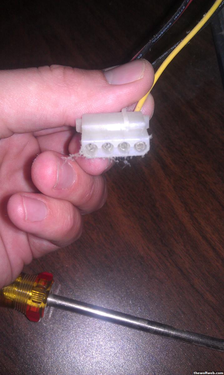

9one9
21497 Posts
Has extra connectors that look like that

69 47
151420 Posts
thats just a standard power cord

9one9
21497 Posts
Which will most likely NOT work for the new card correct?

disco_stu
7436 Posts
You need one of these.
Or two of what you showed plus this maybe:
http://www.amazon.com/StarTech-com-6-Inch-Express-Adapter-LP4PCIEXADAP/dp/B0007RXDDM/ref=sr_1_2?ie=UTF8&qid=1344537300&sr=8-2&keywords=6+pin+molex+adapter
But like I said, get pictures of the back and sides of the box and we could tell you exactly what you need. How much is he asking for the card, btw. We might be able to find you a new card that will definitely work.

Stimwalt
15292 Posts
"I did not know the only requirement for a card to work was having the same slot..."
It isn't the only requirement, Noen was just being lazy. It needs enough power from the Power Supply Unit (PSU), as well as the proper cable connectors from the PSU, and enough physical space to fit inside the Case.

9one9
21497 Posts
XP
8/9/2012 9:42:57 PM
9one9
21497 Posts
[Edited on August 9, 2012 at 9:58 PM. Reason : looks like it will work!]
8/9/2012 9:58:13 PM
disco_stu
7436 Posts
lol, that is a 4 pin molex. What a janky card. How much is he asking for it?
8/10/2012 10:05:16 AM
19012 Posts
agp cards only had 4pin molex wide (hdd style) and thin (fdd) style. the 6 and 8 pin connectors are PCI-E only
