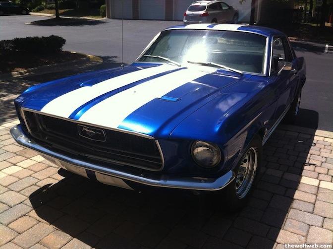

got mine back from the shop today
7/23/2012 12:54:31 PM
richthofen
15758 Posts
Looks good!
7/23/2012 2:57:12 PM
1in10^9
7451 Posts
love the classic stripes. well done!
