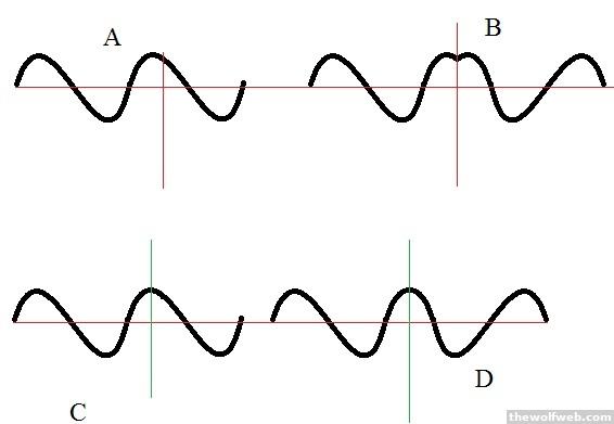

If everything went according to plan then we should have a gif that looks like my first attempt. Im not sure the best way to explain why it looks so weird but hopefully this paint image will help
The problem is that at the end of our gif, the dogs are not at the end of their bobs so the small leftover piece as they start back down/over gets reversed and since its so small, the image looks weird. Images A and B are the 1st attempt, Images C and D are what we are about to do.
SO, now the frames will need to be looked at so we can make the end frames the maximum/minimum. In the middle, 19 through 25 need to be removed. At the ends 1-3 need to be removed and 40-43 should be removed. (actually I left 40 but now that im going back i think it might look better without it) so make a copy of all the frames (in case you decide you want to replace one of the frames) and in a different folder, paste the frames and delete the ones you dont want.
Since in order to compile the gif, the file names need to be continuous, start at 26 and rename everything so that you have 4-32 (or 33)
Now remake the gif by opening 4 with gimp, Video -> "frames to image" -> ok, in new window save as a ".gif" file ( in case you skipped making the 1st gif just put .gif in the file name), click save, click "save as animation" -> export -> adjust frame delay -> save
Hopefully you now have my final product
