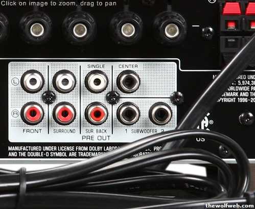

okay, so, just to clarify...in the picture below (just a random receiver picture i found, not one i'm actively looking at buying), the round, multi-colored connectors on the right-hand side are POWERED? i like your idea, Chance, of getting some cheap female connectors and stripping those, instead, so i could do that, strip the wires and hook up the speakers using those round connectors and they'll be powered by the receiver?
if so, awesome...and if that's the case, is there any way i can use the existing sub? i figure not considering how it's arranged, but i'm okay buying a separate sub

No, I think you misunderstood me. Pre-out is pre-amplifier and is not powered. Pre-out is designed to let you use another amplifier.
bare-wire = amplified & direct to speakers
rca = pre-out, not amplified
With the Sony you posted, you should be able to use your existing speaker set up. You want to get 2 sets of stereo RCA - 3.5mm stereo cables & 1 mono RCA - 3.5 mm mono cable. You'll use the 2 stereo cables to run front L/R to the "Front" input on the sub & the rear L/R/ to the "Rear input on the sub and then the mono input will go from the center output to the center input on the sub. Then your sub is going to use a built-in crossover to grab the low frequencies from the front channel. (Most decent receivers will allow you to "cut off" the subwoofer output and make the front outputs full frequency). The only issue you may run into is with volume but it shouldn't be anything major and shouldn't require more than playing around with the gain or possibly turning the volume up a bit louder than normal.
*edit* Actually, does that last input on the sub say "Center/Sub"? If so, you need only 3 of the stereo cables instead of the 2 stereo/1 mono.
I also forgot to add that you should need only one of those sub outputs. Subs are mono and I'm going to assume that it has 2 outputs for a nicer dual-sub set-up rather than an actual stereo output. Worst case you'll have to get a y-adapter to combine them to one signal though I really don't think that would be the case with an ES receiver.

Need to find out what the impedance is on your speakers. If they're 8-ohm then you're good to go either way (may have to rig the sub up with a mono-stereo rca adapter or something). If they're 4-ohm then you'll likely kill that new one pretty quickly.
edit: Actually, looks like they are 8-ohm so you should be good to go. If you go with the newer receiver, a mono to stereo adapter running from the subwoofer output on the receiver to the front channel input on the sub should get you up and running. I didn't check but if there's a tape/md input on the receiver then it should have a monitor out as well that's in stereo that should be full time if you want to use that instead of the sub-out & adapter. Difference is using the receiver's crossover with the sub-out vs. the sub's crossover with the monitor out.
another edit: Personally, I'd keep the ES. It's several orders of magnitude higher quality imo. It is older but I think you have as good a chance of it still working in a year or two as you do with the newer one. You'd probably have an easier time reselling the new one on CL as well.
