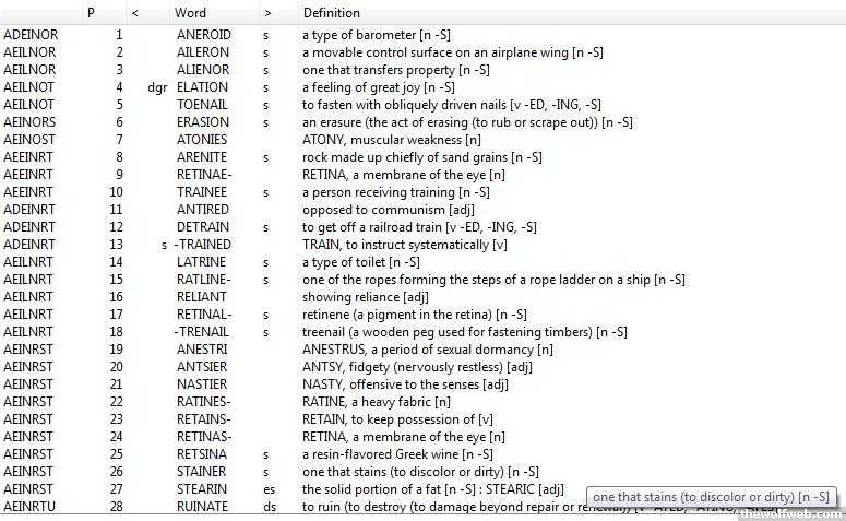

So one of my favorite hobbies is playing Scrabble. Believe it or not there is a fairly large subculture of people who play this game very seriously. Yes, many of them are really dorky and have virtually no social skills, but there are some "normal" people too. Anyway, the game goes far beyond what most people have played casually. There are well over 100,000 words that serious players memorize, many of the words (I'd say roughly 75% of them) are words you would never know if you did not see them listed and study them. [/lame intro]
Seen above is a screen capture of a program called ZYZZYVA (which incidentally is a word) that unscrambles words, creates quizzes, etc. One of the functions it has is determining probability, which is a great way to study. In other words, you are much better off studying words like AILERON or DARIOLE made with common letters with higher probability than words like FILIBEG or FUMULUS, at least initially. So what I was wondering is how does this program go about determining the probability of playing a word? Here is the letter distribution:
At first I thought I could assign a probability to each letter (for instance E=12/100, G=3/100, Z=1/100) and then just multiply all these numbers together, take the inverse of the product, and whichever letter combination had the highest value would be the most probable. Well, just by using this method on a few different cases I found it to be an epic FAIL. I would personally think a word like BEEBEES would be near the top considering it has 4 E's, which appear at the highest probability, along with BBS, which are not totally uncommon. However BEEBEES is about 23,000 of 24,000 7-letter words.
Being able to calculate this during a game would be an immense help. So if anyone out there could give me some help, I would be greatly appreciative.
