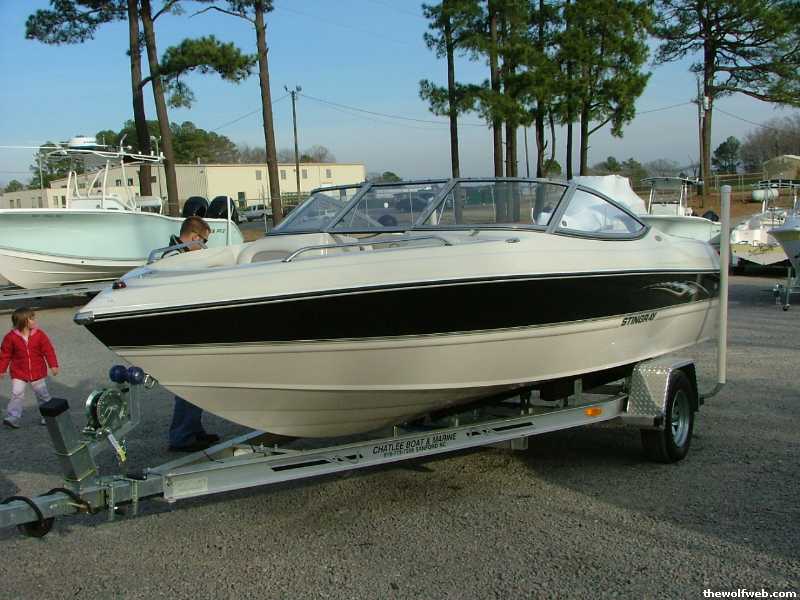

just picked up my new money pit on wednesday, more pics in gallery!

^ yes, my bro-in-law works down there in the shop, and the wife's family is friends with the owners, so a natural fit, it's a 2006 stingray 195lr with the merc. 4.3 carb with Alpha 1 drive. haven't had it in the water outside of their test pond, can't wait for the weather to break!

i'm considering putting in tommorow after a quick trip up to overtons to pick up some last minute items, we've (family) done quite alot of business with them and with us getting into it i'm sure this won't be our last boat from them. in the future probably looking to go up to a 23 or 24 foot sport/cruiser or possibly a center console if the urge strikes. too bad they can't get sea ray because i have a feeling that's where we'll eventually end up in a bunch of years in a 26-30' sundancer or something of the like

Maybe so, but Stingray is where it's at as far as hull design and efficiency.

yeah i have done a bunch of research and have been waiting for about 2 years to buy this boat, and I am very happy with the purchase so far. I wish Stingray made something bigger than 25 though for that later in life boat! oh well one can dream!

Nice Stingray. I wish I wasn't so stuck on getting a wakeboard boat because you can get so much more for your money in a normal I/O runabout.

^^ thanks, yeah i'm not too big in to skiing or wakeboarding, yet.. but just something to take out on the lakes and have a good time on my short weekends or my days off during the week as we're normally at the beach every 2 day weekend i get!
