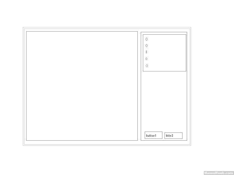

without using absolute postioning, I am trying to place two buttons on the bottom of my JPanel (control panel) that is set on the right side.
I have a panel of radio buttons inside of the control panel.
at the bottom of my control panel I want two buttons. When I add the button panel to the control panel
 (using p.add(buttonPanel, BorderLayout.SOUTH); // P is ControlPanel)
it only places them just below my radio button panel. Maybe a couple of pixel below and not at the bottom.
I tried adding in a temp panel for CENTER but it didn't work.
[Edited on January 30, 2006 at 6:18 AM. Reason : ff]

try
p.setLayout(new BorderLayout());
prior to adding the interior panels.
1/30/2006 6:00:07 PM
zorthage
1+1=5
17149 Posts
use GridBagLayout http://java.sun.com/j2se/1.5.0/docs/api/java/awt/GridBagLayout.html
It lets you put things in a grid, so you can place the items more intuitively.
